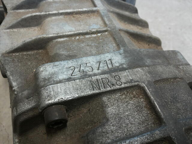

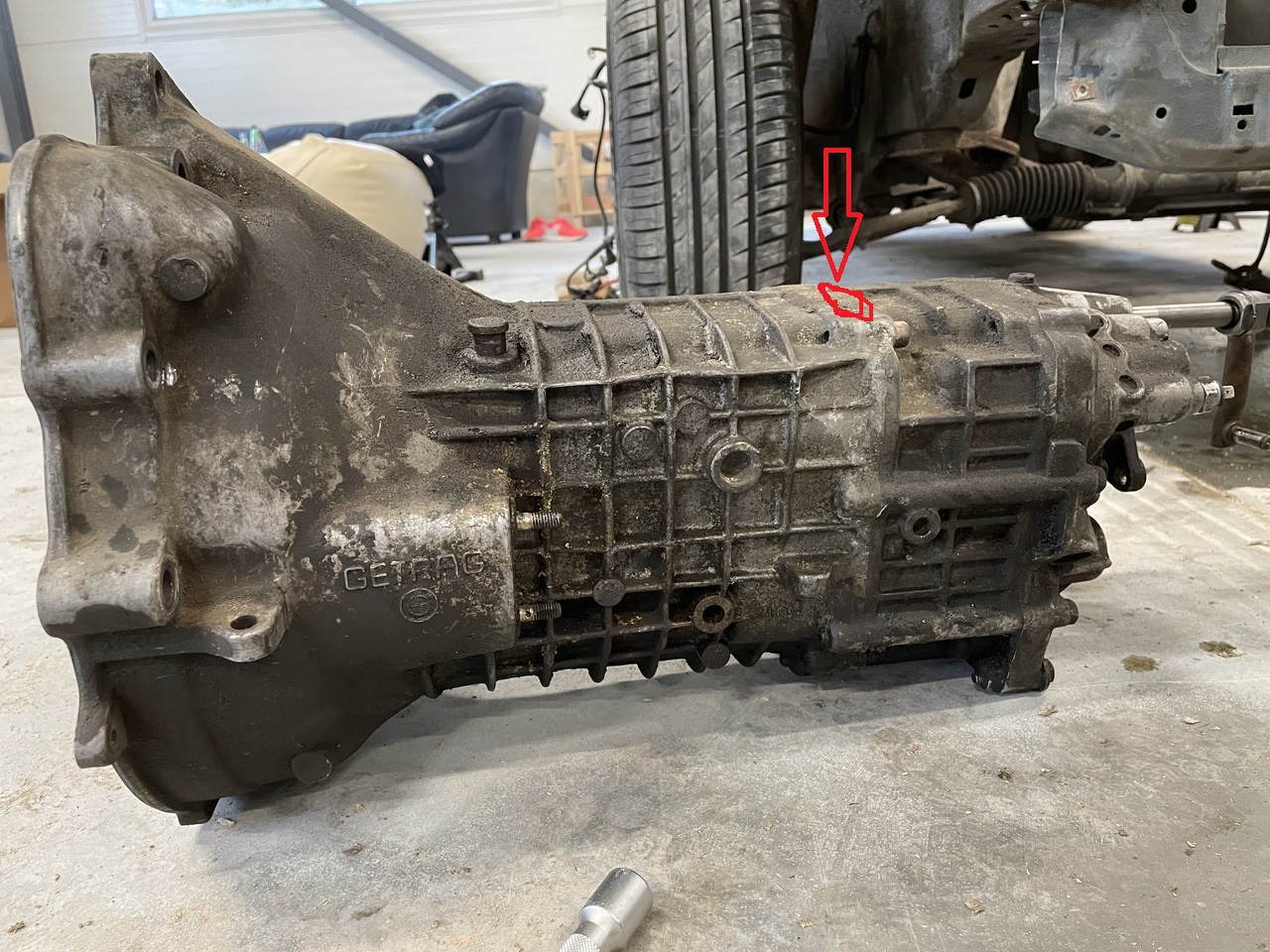

Kurikuulus dogleg. Kusjuures proovisin leida mingit marki või mudelit, tutkit vasja. Ainukene mis leidsin oli Getrag M60. Muidugi see tähtis markeering võib olla kuskill kõntsakihi all.

Siin ei ole?
Mul oli doglegil sedasi:

Standardina on käimarite mudelinumbrid seal võlli väljumisosas, ehk siis kasti tagaotsas võlli all, veidi vaja õli ja pori maha pühkida.

Kui garaazi saan, kontrollin üle. Ennast lihtsalt huvitab, et mis mudeliga täpsemalt tegu. Nagu olen aru saanud, siis on neid kaste nii M3, kui ka 323i peale pandud, mis kandis siis "sport gearboxi" nime. Kas nad ka mudeli osas samad, seda ei tea. Getrag 265/5 ja getrag 265/6.
Nagu interneedus väitis, siis 323i peal on "sportgetriebe" ja mudelinumber on 260. Ehk siis kolmas variant juba ? Ma olen veidi segaduses juba, et mis on kes, ja miks on kus ? :mrgreen:
Edit:
G265/6
Used on '82 528e and '85 535i. Also on '85 6/735, '80-'81 E12, '81-'82 6/733s and E30 M3s. Considered the strongest transmission available for E28’s. Is easily identified by a removable bell housing which allows use on M10, M20 and M30 engines, as long as the correct bell housing is used or reused. All except M3s have a sheet metal shifter support. It’s use in '85 M30 powered cars was reportedly dictated by the short life of the 260/5 in those cars. Overdrive 5th.
G265/5
Never available on US spec cars, it's a close ratio 5 speed similar to the 265/6 overdrive transmission. 5th gear is 1:1. Often incorrectly called a 262 close ratio or dogleg, but a 262 is a 4 speed transmission. All 265’s I’ve seen have the front case casting with a 262xxx casting number, but they are 265s if they are 5 speeds. Removable bell housing and it does have an unusual shift pattern with 1st being off by itself and 4th/5th across from each other instead of 5th being up by itself.
Sellise info leidsin https://www.mye28.com/viewtopic.php?t=61367 lehelt. :roll:
Postitusi: 3096
Re: BMW E30 320i 1986 Marko S
Minu oma on getrag 245/11 ja sul näeb see asi väga sarnane välja ;)

Eks kõige lihtsam on lihtsalt minna garaazi, võtta kätte traathari ja puhastada see koht, kus võiks olla mudelinimetus. Me siin ilmselt võime oletada tervelt mitu head lehekülge enne, kui jõuame tulemuseni, et oleks pidanud garaazi minema. :D
Marko s kirjutas: 04 Okt 2021 12:58 Getrag 265/5 ja getrag 265/6.
/5 on dogleg ja /6 tavaline OD kast. Aga siin pildil pole kumbki neist, 265 on polditava sidurikojaga.
Mu silmad võivad küll petta aga mulle tundub, et kastil on ka spidomeetri trossi kinnitusava. Seega võiks olla jah 245/11 e21 pealt.
Ega ma siin targematega hakka vaidlema. Minu jaoks koerajalakastiga üldse elus esimene kokkupuude. Hea, et ma üldse suutsin vahet teha. :mrgreen: :mrgreen:
